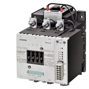

já agora, a siemens (e logo esta, o colosso electrotécnico), propõe no seu catálogo, contactores com "medidor de vida útil" dos contactos do contactor, que medem o desgaste dos mesmos:
Siemens Offers Large Frame Sirius 3R Contactors With Remaining Lifetime Indication
ALPHARETTA, Ga., April 16, 2002 - Siemens Energy & Automation, Inc., has introduced new Sirius 3R large frame contactors rated from 115A to 500A with an optional Remaining Lifetime (RLT)indication feature.
Typically, contact wear is estimated by the number of cycles counted, which provides little or no information about actual contact erosion. The new Sirius 3R RLT system measures the actual contact erosion electronically, indicating the estimated remaining lifetime on an LED display at the contactor. The indication can be processed via a relay output or bus signal.
This new RLT option can reduce costly down time due to worn contact tips without costly and time-consuming visual inspection by maintenance staffs.
The RLT indication option can be ordered on the standard air-break
contactors as well as the vacuum contactors.
